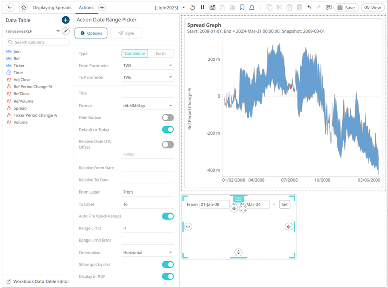

The Action Date Range Picker pane is displayed, and the Action Date Range Picker part is added on the dashboard canvas with the current date range (parameters From Date to To Date) and the Set button.
For this example, the following parameters are defined:
Parameter Name Type Default Value Ticker
Text
Cost
TWS
Text
2008-01-01
TWE
Text
2008-01-01
SS
Text
2008-01-01
These parameters are used on the Title of the Line graph (e.g., Start: {TWS: yyyy-MMM-dd HH:mm:ss}, End = {TWE: yyyy-MMM-dd HH:mm:ss}, Snapshot: {SS: yyyy-MMM-dd HH:mm:ss}).

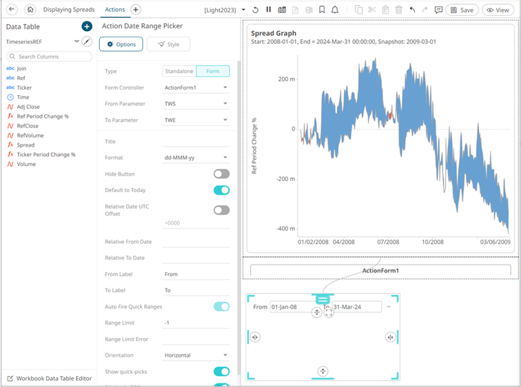

- The action date range picker can be configured to either be a Standalone or a Form component.
When set to Form, the action date range picker can be be connected to any form controller on the same dashboard. The parameters that the action part can set depends on how the form is configured.
NOTE: An action form part must be defined first to associate the action date range picker as a component. Refer to Adding an Action Form more information.
A line connects the component to the associated form.
If the action date picker should not be connected to a form, it can be set to Standalone instead. Select the parameters that will be used for the From Parameter and To Parameter dates range.

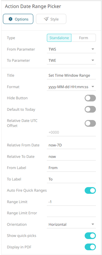

- Instead of turning the Default to Today slider on, enter the following date range values:
- Relative From Date or the start Date/Time
- Relative To Date or the end Date/Time
This allows the relative date calculation (based on today’s date), by parsing the input text string.

The special now term can also be used, this represents the current Date/Time. For example:
- Using now will set the date picker to the current Date/Time
- now-7D will set the date picker to 7 days ago. This is the same as specifying
-7D
For example:
The From date will be now-7D and the To date will be now by default.
For example, now is April 9, it will go back 7 days (April 2) and then the date will be recalculated.

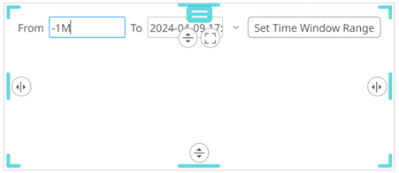

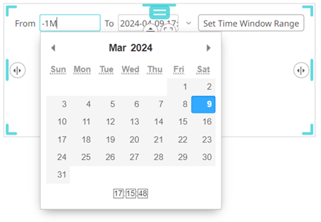

In addition, you can use the SIGN UNIT NUMBER pattern to modify the relative date calculation.
For example, if you enter -1M:
The recalculated relative date will be September 26:

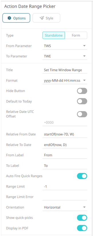

In the expression, you can also use startOf and endOf functions. Both functions take the same arguments, a relative time string, and a unit.
Lastly, you can define a complex expression with the functions. For example, if you enter startOf(now-7D, W) as the Relative From Date and endOf(now, D) as the Relative To Date:
The From date will display the start of the previous week and the To date will display the end of the current day:

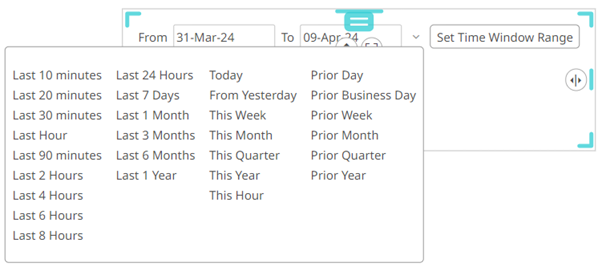

- The Show quick-picks option is enabled by default. This allows you to select from pre-populated date ranges.
See to Selecting Relative Dates in Action Date Picker and Action Date Range Picker Controls for more information.
Tap the slider to turn off this option.

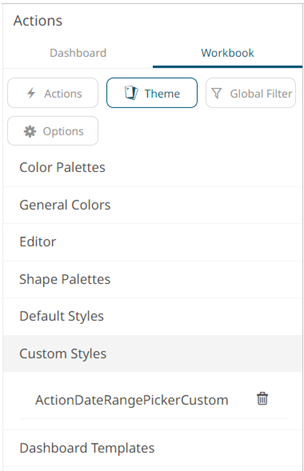

- If there are additional changes made, click Update Current Style in the Update Style drop-down.
The new custom style is added in the Workbook > Theme > Custom Styles list.
If published, the custom style configuration of the Action Date Range Picker will be added to the Global custom styles list and can be applied to other parts.
