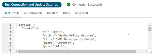

. A successful connection will result to the following:
- The Connection Successful status is displayed along with some raw data returned by the server.

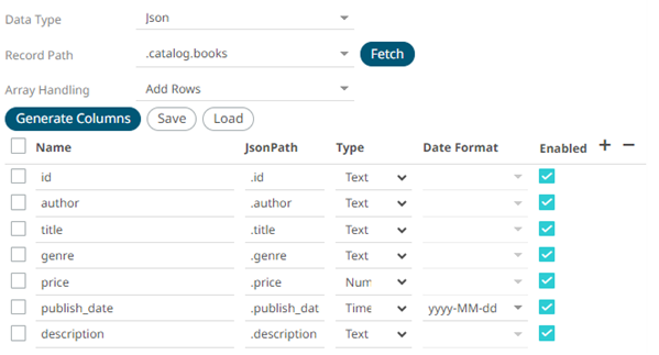

- The connector tries auto discovery of the Data Type (JSON, Text, XML, Excel, HTML, Arrow IPC)
When loading JSON data, the Record Path can be suggested automatically by pressing the Fetch button. Refer to the section Supported JSON Structures for details about the available options for turning the JSON into a table structure.

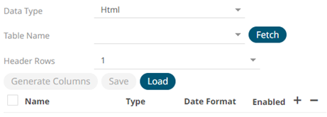

For the Web Data connector, you can also select the HTML data type.
Property Description Table Name
Click
to fetch HTML table elements then select the HTML table.Header Rows
Select the number of rows in the table to be retrieved as column headings. The default value is 1, but a higher number should be set if the HTML table has column titles that use more than 1 row. If all rows of the table are data and there are no column headers, set it to 0.
NOTE: If no table element is found in the HTML document, an error message displays.
You can also opt to load or save a copy of the column definition.

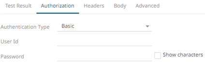

Basic
Enter the User ID and Password to connect to the connector’s service.
Select the Show Characters box to display the entered characters.

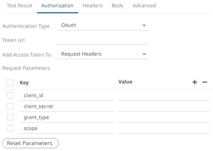

OAuth
Some standard OAuth token request parameters come initialized with empty values. You can set these values and also add/remove any/all of the keys.
Enter or select the following settings:
Token URL – The URL to retrieve the access token from.
Add Access Token To - The Access token retrieved from the Token URL can be added to headers, URL, or request body, depending on how the endpoint needs the token.
Request Headers - A header is automatically added to the REST API request.
Request URL - The URL needs to be manually parameterised with a {access_token} parameter, before calling the REST API, the parameter is replaced with the actual token.
Request Body - The Request Body needs to be manually parameterised with a {access_token} parameter, before calling the REST API, the parameter is replaced with the actual token.
NOTE: The given request parameters key/value pairs are formatted by the connector as application/xwww-form-urlencoded, and posted to Token URL.

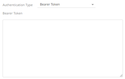

Bearer Token
If you already have a authentication token, enter the token string into Bearer Token input box. This can be parameterized also.

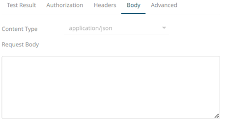

- Set the Body if a POST/PUT request is required.
- Select the Body tab.
- Set the required settings:
Property Description Content Type
Select or enter content-type based on request body (payload) format.
NOTE: This property is disabled when the HTTP Method is GET.
Request Body
The Request Body for the HTTP POST method.

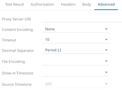

Property Description Proxy Server URI
The HTTP Proxy setting that will allow the connector to reach the endpoint.
Content Encoding
Select the Content Encoding with the HTTP Header: None, GZip, Deflate, or GZip and Deflate.
Timeout
The length of time to wait for the server response (10 to 300). Default is 10.
Decimal Separator
Select either the dot (.) or comma (,) as the decimal separator.
File Encoding
Set the character encoding to use in text data.
UTF-8
UTF-16
US-ASCII
Windows-1252
- You can opt to define the Show in Timezone and Source Timezone settings.
