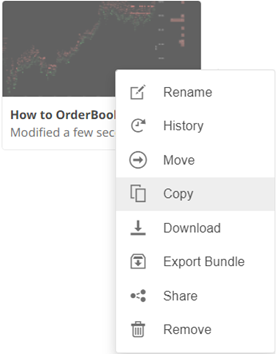

  1. Right-click on a workbook or click More Actions  and select Copy in the context menu.

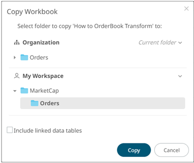

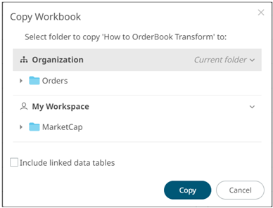

    The Copy Workbook dialog displays with the folder or subfolders the user is allowed to copy the workbook.
  2. Select the folder or subfolder.
  3. Select the Include linked data tables checkbox so the associated data tables linked inside the workbooks will be included when copying.
  4. Click  .
    The workbook is copied and displayed on the selected folder.
