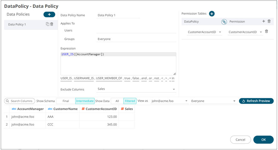

The data table and Permission Table are linked based on CustomerAccountId.

Here are data policy access rule examples:
USER_IS([AccountManager])
USER_MEMBER_OF("Managers")
USER_MEMBER_OF("Managers") AND USER_MEMBER_OF("IndiaTeam")
USER_IS([AccountManager]) OR USER_MEMBER_OF("SalesLead")
USERNAME_IS([UserNameColumn])
