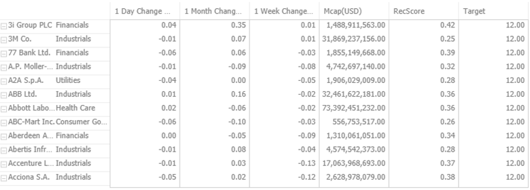

For the Table and Heat Matrix visualizations, Copy Cell Data is also available which allows copying of a single cell.

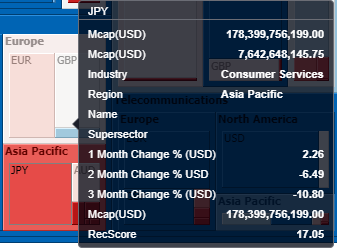

The data exported will be what appears on screen, or in a linked table. Specifically, all the columns that appear in the Detail pop-up, including:
- Only those items that are visible (for example, items that have not been filtered)
- Same Visible detail (or depth) level displayed in the visualization.

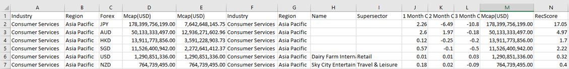

Data for a single item can be exported by selecting the item.
Right-clicking selecting Copy Data on the context menu displays the Copy to Clipboard button.
Click
to copy and paste the data to another application such as MS Excel.
