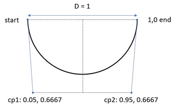

The c command takes 3 points (x, y) as arguments: the first two are control points and the third is the end point. To draw the lower half of a circle with a diameter of 1, drawing from left to right, you can use these control point values. All points are expressed relative to the starting position. Remember that the y-axis is positive in the downwards direction.
controlpoint 1: x = 0.05, y = 0.6667
controlpoint 2: x = 0.95, y = 0.6667
end point: x = 1, y = 0
which makes:
c 0.05, 0.6667 0.95, 0.6667 1, 0 z
