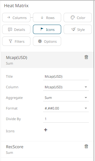

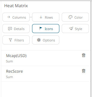

  1. To associate columns from the data table, drag and drop them to the Icons variable drop area. Select a numeric column to display the corresponding configuration pane.
    This displays the configuration pane.
  2. Enter the label of the Icons variable in the Variable Title field.
  3. You can also change the column to the be used as the Icons variable from the Column drop-down list.
  4. Specify an aggregation method in the Aggregate field.
    The default is Sum.

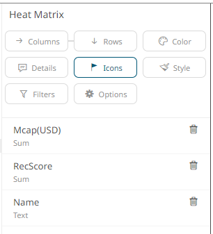

  1. To associate columns from the data table, drag and drop them to the Icons variable drop area. Select a text column to display the corresponding configuration pane.
