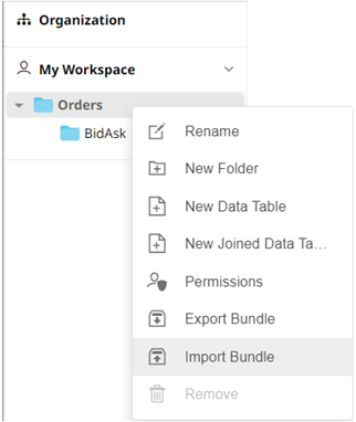

- Right-click on a folder and select Import Bundle in the context menu.

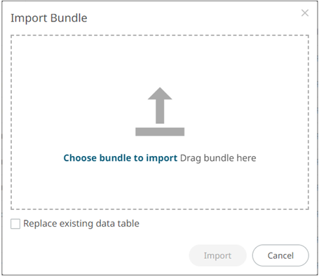

The Import Bundle dialog displays
- To import a bundle, you can either:
- Drag it from your desktop and drop on the dialog, or
- Click Choose Bundle to Import and select one on the Open dialog that displays.
The name of the selected bundle is displayed on the dialog box.
- To replace existing data tables, select the Replace existing data table checkbox.
