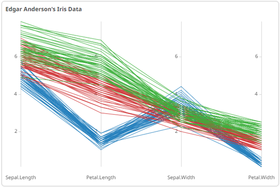

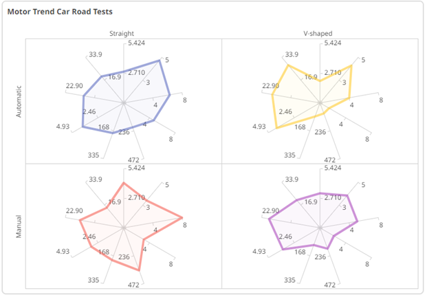

Ready-made Radar Graph and Parallel Coordinates Graph are available in the Examples bundle. Here are some examples:
Radar Graph

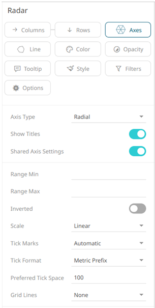

Detailed settings under the Axes pill.
| Pill Settings | Description |
Axis Type |
Radial, Horizontal, or Vertical. |
Show Titles |
Determines whether the titles will display for the axis or axes. |
Shared Axis Settings |
Determines whether most of the axis settings should be per axis or shared among all axes. Shared axis settings are the most common for radar graphs while individual axis settings are the most common for parallel coordinate plots. |
Range Min and Range Max |
The range of the radar axis. Automatically set values are shown in gray font, while explicitly set values are shown in black font. |
Inverted |
Makes the radar go from right-to-left instead of from left-to-right, or from top-to-bottom instead of bottom-to-top in the case of Vertical axis type. |
Scale |
Sets the type of scale to use on the radar axis. Can be Linear, Power, or Log. Default is Linear. |
Tick Marks |
Controls the number of tick marks to show along the radar axis. Options are Automatic, Custom, or None. Default is Automatic. |
Tick Format |
Controls the formatting of the tick mark labels. Options are Metric Prefix or Custom. Default is Metric Prefix. |
Preferred Tick Space |
The preferred space in pixels between the minor grid lines across the axis. Default is 100. |
Grid Lines |
Determines how grid lines are drawn across the axis. Allowed values include None, Dotted, Dashed, or Solid. |
By drag-dropping a numeric or text column on the Axes pill or on the Axes stack, a radar visualization will immediately appear, and the automatic values will be set for the Range Min and Range Max fields.
Columns that are added, or a stack of reorderable independent axis setting, represent the data dimensions. These columns can be renamed or deleted, and the aggregate can be modified.

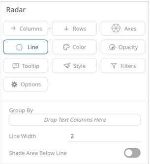

Detailed settings under the Line pill.
Group By |
Text columns that will be used to group the line members in the X-axis graph. |
Line Width |
Specifies the width in pixels of the lines. |
Shade Area Below Line |
Defines that opacity shades are applied between the lines and the zero Y grid line. |
