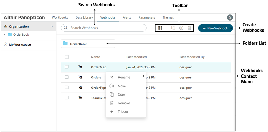

| Property | Description |
Entering text will filter the webhooks. |
Toolbar |
Allows you to copy, move, and remove webhooks. Also, to display the webhooks list either on List View or Grid View. |
Create Webhooks |
Allows you to create new webhooks. |
Webhooks Context Menu |
Allows you to rename, move, copy, delete, and enable the trigger of webhooks. |
