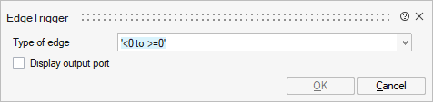

edge | Type of edge | This parameter defines the type of edge. 7 types are supported. | String | '<0 |
showport | Display output port | The direction of the crossing is optionally available as a block output. The value 1 indicates a rising edge and the value -1, a falling edge. This outpout is available only for edge options ">=0 to <0" "- to +" "+ to -" and "Zcross". | Number | 0 |
