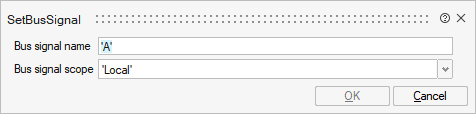

The "Bus Signal Scope" parameter defines the scope in which the implicit signal is defined. For more information, please refer to the GetSignal block.Parameters
tag | Bus signal name | The name of the Bus Signal. | String | |
tagvis | Bus signal scope | The scope of the Bus Signal. | String | 'Local' |
