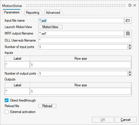

xml | Input file name | MotionSolve or MotionView model file name | String | |
mrf | MRF output filename | MotionSolve ouptut filename (.mrf) | String | |
usub | DLL User-sub filename | String | ||
nin | Number of input ports | The number of input ports on this block must correspond to the number of Control_PlantInput statements in the model. This field is automatically filled if the Reload button is pressed. | Number | |
inports | Inputs | Structure | ||
inports/label | Label | Cell of strings | ||
inports/rowsize | Row size | The input ports can be vectorial, in this case the size of vector is given here. This field is automatically filled if the Reload button is pressed. | Cell of scalars | |
nout | Number of output ports | The number of output ports on this block must correspond to the number of Control_PlantOutput statements in the model. This field is automatically filled if the Reload button is pressed. | Number | |
outports | Outputs | Structure | ||
outports/label | Label | Cell of strings | ||
outports/rowsize | Row size | The output ports can be vectorial, in this case the size of vector is given here. This field is automatically filled if the Reload button is pressed. | Cell of scalars | |
depu | Direct feedthrough | Sets the direct feedthough of the block to true to ensure that when MotionSolve is called, the block inputs are up to date. If an algebraic loop occurs, deselect this option. | Number | 0 |
externalActivation | External activation | Specifies if the block receives an external activation or inherits its activation through its regular input ports. If selected, an additional activation port is added to the block. By default, external activation is not selected. If External activation is selected, the communication with the MotionSolve simulation engine occurs only at event instants such as a fixed-rate event defined by an external clock. | Number | 0 |

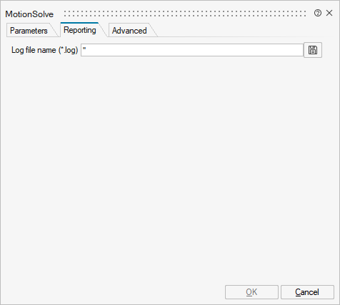

log_file_name | Log file name (*.log) | Twin Activate messages as well as messages communicated from MotionSolve to Twin Activate are logged into this file. | String |

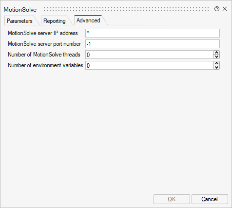

msip | MotionSolve server IP address | Used for TCP communication. Not used in the current release. | String | |
msport | MotionSolve server port number | Used for TCP communication. Not used in the current release. | Scalar | |
nthread | Number of MotionSolve threads | Specifies the number of threads of MotionSolve. If set to zero or negative value, MotionSolve default thread number will be used. | Number | |
nEnvVar | Number of environment variables | Number of environment variables that are passed to MotionSolve. | Number | |
EnvVars | Environment Variables | Structure | ||
EnvVars/varname | Name | Name of the environment variable that is passed to MotionSolve. | Cell of strings | |
EnvVars/varvalue | Value | Value of the environment variable that is passed to MotionSolve. | Cell of strings |
