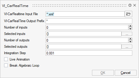

VI_CarRealTime
This block is used to perform co-simulation with VI-CarRealTime from VI-grade.
Activate/CoSimulation
vicrt_inputfile | VI-CarRealtime Input File | Path and filename for the VI-CarRealTime model (.xml) | String | |
vicrt_outprefix | VI-CarRealTime Output Prefix | Prefix to be added to the VI-CarRealTime simulation (.res) result files | String | |
defvalues | Default values | Vector | ||
vicrt_input_dim | VI-CarRealTime input dimension | Scalar | ||
vicrt_output_dim | VI-CarRealTime output dimension | Scalar | ||
nin | Number of inputs | Number | ||
inputs_names | Selected inputs | |||
inputs_indices | Inputs indices | Vector | ||
nout | Number of outputs | Number | ||
outputs_names | Selected outputs | |||
outputs_indices | Outputs indices | Vector | ||
intStep | Integration Step | Scalar | ||
AniFlag | Live Animation | Number | 0 | |
ndepu | Break Algebraic Loop | Number | 0 |
Port 1 | explicit | output | nout | |
Port 2 | explicit | input | nin |
