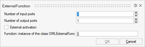

nin | Number of input ports | Number | ||
nout | Number of output ports | Number | ||
externalActivation | External activation | Number | 0 | |
funcObj | Function: instance of the class OMLExternalFunc |
