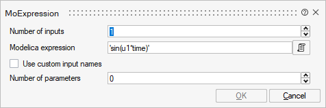

The output of this block is a real scalar obtained by evaluating the Modelica expressions specified as block parameters. The expression is given in terms of variables u1,...un (except if using custom input names) where ui is the ith scalar input.
Activate/CustomBlocks
