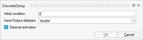

init_cond | Initial condition | The output of the simulation for the first sampling period, during which the output of the DiscreteDelay block is otherwise undefined. | Matrix | |
typ | Input/Output datatype | Specifies the data type of the input and output. | String | 'double' |
externalActivation | External activation | This parameter defines if the block receives an external activation or inherits its activation through its regular input ports. When External Activation is used, an activation port is added to the block. | Number | 0 |
