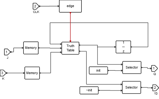

The JK Flip Flop block works on a definite portion of the clock cycle (such as the rising edge of the clock).
The combination J=0 K=0 holds the state, the combination J=1 K=0 sets the state,the combination J=0 K=1 resets the state,the combination J=1 K=1 toggles the state.
The block is enabled when specified edge is detected, the truth table of inputs and outputs is defined as follows:
J K Q !Q
0 0 Qn-1 !Qn-1
0 1 0 1
1 0 1 0
1 1 !Qn-1 Qn-1

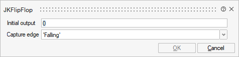

init | Initial output | Output at port Q at initial time | ||
edge | Capture edge | Detect rising or falling edge that enables the block | String | 'Rising' |
