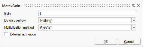

gain | Gain | This parameter defines the matrix Gain. That parameter can support all data types. | Matrix | |
overflow | Do on overflow | Defines the action in case of an overflow during the operation. Options are : "Nothing" (gives a normal, non satured result), "Saturate" (gives a saturated result), "Error" (gives an error message). | String | 'Nothing' |
mulmethod | Multiplication method | Defines how the matrix multiplication is performed. In the other words, it specifies whether the product is a left, right or element-wise multiplication. | String | 'Gain*u1' |
externalActivation | External activation | Specifies whether the block receives an external activation or inherits its activation through its regular input ports. When External Activation is selected, an additional activation port is added to the block. By default, external activation is not selected. | Number | 0 |
