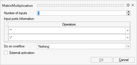

nin | Number of inputs | Number of block inputs. | Number | |
in_ports | Input ports Information | Information about the input ports. | Structure | |
in_ports/sgn | Operators | * indicates the corresponding input is to be multiplied with other inputs. | Cell of strings | '*' |
overflow | Do on overflow | Flag to not take a specific action if integer overflow occurs. Default: 'nothing' | String | 'Nothing' |
externalActivation | External activation | Specifies whether the block receives an external activation or inherits its activation through its regular input ports. When External Activation is selected, an additional activation port is added to the block. By default, external activation is not selected. | Number | 0 |
