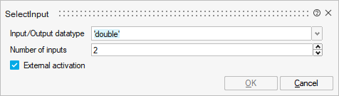

typ | Input/Output datatype | Specifies the data type of the input and output. | String | 'double' |
nin | Number of inputs | Specify the number of input signals to be selected. | Number | |
externalActivation | External activation | The same number of activation inputs as regular inputs are added to the block when selected. The external activation determines which input to be copied to the output. Default is OFF. | Number | 0 |
