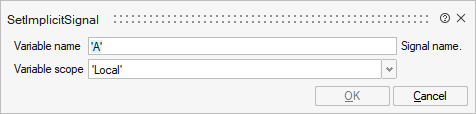

The "Variable Scope" parameter defines the scope in which the implicit signal is defined. For more information, please refer to the GetSignal block.Parameters
tag | Variable name | String | ||
tagvis | Variable scope | Scope of the given signal. Default: local. | String | 'Local' |
