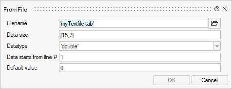

This block allows reading data from files, in particular, CSV, TAB, or TSV.
Activate/SignalImporters
fname | Filename | String | ||
outsize | Data size | The output port size will be the same as the input file size. If the data read from the file is less than the output size, initial value is used for the rest of output. If the data read from the file is more than the output size, the extra read data from file is ignored. Any character except numeric data i.e., ".dDeE+-0123456789" can be used as delimiter between numerical data. Only numerical data can be read from file. The block reads the whole data stored in the file. | Matrix | |
vardatatype | Datatype | String | 'double' | |
Offset | Data starts from line # | Scalar | ||
initial | Default value | Initial value is used for time instants before the activation of the block. Initial value can be either a scalar or a matrix. | Matrix |
