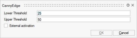

lowerThreshold | Lower Threshold | Specifies the lower threshold. Edges with an intensity gradient lower than the Lower Threshold are discarded. | Scalar | |
upperThreshold | Upper Threshold | Specifies the upper threshold. Edges with an intensity gradient greater than the Upper Threshold are retained. | Scalar | |
externalActivation | External activation | This parameter defines if the block receives or inherits an external activation. When External Activation is used, an additional activation port is added to the block. Default is OFF. | Number | 0 |
