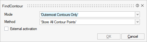

Mode:
Outermost Contours Only: retrieves only the extreme outer contours.
All Contours, No Hierarchy: retrieves all of the contours without establishing any hierarchical relationships.
All Contours, 2 Level Hierarchy: retrieves all of the contours and organizes them into a two-level hierarchy. At the top level, there are external boundaries of the components. At the second level, there are boundaries of the holes. If there is another contour inside a hole of a connected component, it is still put at the top level.
All Contours, Full Hierarchy: retrieves all of the contours and reconstructs a full hierarchy of nested contours.
Method:
Store All Contour Points: stores absolutely all the contour points. That is, any 2 subsequent points (x1,y1) and (x2,y2) of the contour will be either horizontal, vertical or diagonal neighbors, that is, max(abs(x1-x2),abs(y2-y1))==1.
Compress Simple Segments: compresses horizontal, vertical, and diagonal segments and leaves only their end points. For example, an up-right rectangular contour is encoded with 4 points.
Teh-Chin L1 Approximation: applies one of the flavors of the Teh-Chin chain approximation algorithm.
Teh-Chin KCOS Approximation: applies one of the flavors of the Teh-Chin chain approximation algorithm.
mode | Mode | Indicates the contour retrieval mode. | String | 'Outermost |
method | Method | Indicates the contour approximation method. | String | 'Store |
externalActivation | External activation | This parameter defines if the block receives or inherits an external activation. When External Activation is used, an additional activation port is added to the block. Default is OFF. | Number | 0 |
