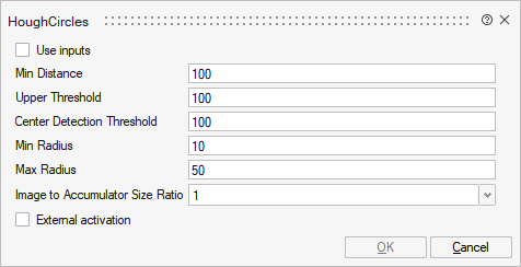

useInput | Use inputs | Use inputs to define threshold values. | Number | 0 |
minDist | Min Distance | Specifies the minimum pixel distance between the center of detected circles. | Scalar | |
upperThreshold | Upper Threshold | Specifies the upper threshold for the Canny Edge detector. | Scalar | |
centerDetectionTreshold | Center Detection Threshold | Specifies the threshold for the circle centers. The smaller it is, the more false circles may be detected. Circles, corresponding to the larger accumulator values, will be returned first. | Scalar | |
minRadius | Min Radius | Specifies the minimum pixel radius for the circles to be detected. | Scalar | |
maxRadius | Max Radius | Specifies the maximum pixel radius for the circles to be detected. | Scalar | |
im2AcR | Image to Accumulator Size Ratio | Specifies the inverse ratio of the accumulator resolution to the image resolution. If the ratio is 1, the accumulator has the same resolution as the input image. If the ratio is 2, the accumulator has half the width and height. The lower the ratio, the more accurate the circle detection is; however, the more accurate the detection, the more likely it is to miss slightly degenerated circles or detect multiple circles instead of single circle with a large edge. | Scalar | 1 |
externalActivation | External activation | This parameter defines if the block receives or inherits an external activation. When External Activation is used, an additional activation port is added to the block. Default is OFF. | Number | 0 |
