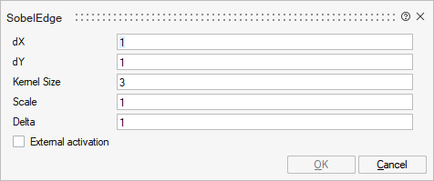

dx | dX | Indicates an integer variable representing the x-derivative. | Scalar | |
dy | dY | Indicates an integer variable representing the y-derivative. | Scalar | |
ksize | Kernel Size | Specifies a value used to extend the Sobel kernel. The value must be odd and positive and less than 32. | Scalar | |
scale | Scale | Indicates the scale value for the computed derivative values. The scale value helps to visualize a derivative in an image. | Scalar | |
delta | Delta | Specifies a value used to vary the pixel intensity. The delta value is added to the results prior to storing them in the output. | Scalar | |
externalActivation | External activation | This parameter defines if the block receives or inherits an external activation. When External Activation is used, an additional activation port is added to the block. Default is OFF. | Number | 0 |
