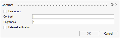

useInput | Use inputs | Use inputs to define the contrast and the brightness | Number | 0 |
contrast | Contrast | Specify the values to control the contrast value of every pixel in the image. Specify the values as integers between 0 and 100. | Scalar | |
brightness | Brightness | Specify the values to control the brightness value of every pixel in the image. Specify the values as integers between 0 and 100. | Scalar | |
