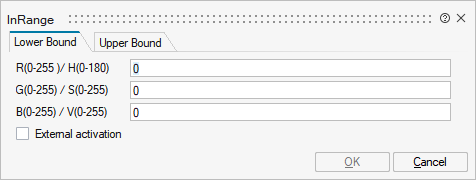

lb0 | R(0-255 )/ H(0-180) | Indicates the threshold for the minimum pixel value for red. | Scalar | |
lb1 | G(0-255) / S(0-255) | Indicates the threshold for the minimum pixel value for green. | Scalar | |
lb2 | B(0-255) / V(0-255) | Indicates the threshold for the minimum pixel value for blue. | Scalar | |
externalActivation | External activation | This parameter defines if the block receives or inherits an external activation. When External Activation is used, an additional activation port is added to the block. Default is OFF. | Number | 0 |

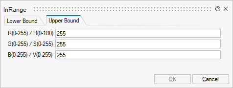

ub0 | R(0-255) / H(0-180) | Indicates the threshold for the maximum pixel value for red. | Scalar | |
ub1 | G(0-255) / S(0-255) | Indicates the threshold for the maximum pixel value for green. | Scalar | |
ub2 | B(0-255) / V(0-255) | Indicates the threshold for the maximum pixel value for blue. | Scalar |
