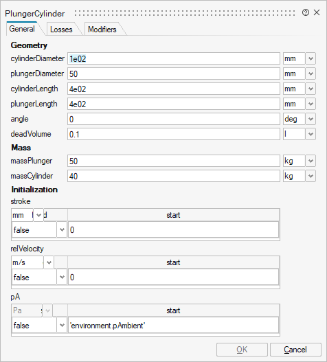

The fundamental geometrical properties of the plunger cylinder are the cylinder and plunger diameters (Inner diameter of cylinder, Plunger diameter) as well as the lengths of the cylinder and the plunger (Cylinder length and Plunger length). By using the parameter Inclination angle, the inclination of the cylinder with respect to the horizon can be adjusted. The resulting forces due to gravity are taken into account automatically.
For dynamic calculations, the masses of the plunger and the cylinder are required. These can be provided by specifying the parameters Plunger mass and Cylinder mass. The dynamic mass of the fluid, which acts as an additional inertia, is automatically taken into account by the model.
The parameters Breakaway friction force, Constant friction/Coulomb force, Velocity dependent friction and Velocity parameter for Stribeck friction (velocity where the friction force begins to grow linearly) characterize the velocity dependence of the friction force between piston and cylinder. Instead of using the Stribeck friction model, a simplified friction calculation can be enabled by setting the check mark relFric. In this case, the friction force equals the net force acting on the interface between piston and cylinder multiplied by the parameter Relative friction factor. Regardless of which friction model is used, the friction force is not influenced by the inclination of the cylinder or the system pressure. The parameter Relative velocity near to zero is used by the internal state machine of the cylinder model and determines the velocity below which the piston is considered stuck.
The pressure in the chamber can be initialized by assigning start values to Pressure in chamber A. The parameter Dead volume determines the size of the parasitic volume which remains even if the plunger has reached the mechanical stops at the cylinder ends.
The volumetric losses due to external leakage are parameterized by providing the flow rate (External leakage: volume flow), associated pressure drop (External leakage: pressure difference) and the fluid density Reference density for volume flow and pressure difference for which these values were obtained.
