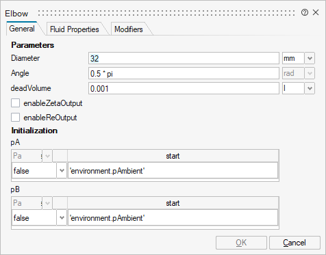

mo_Diameter | Diameter | Diameter | Scalar | |
mo_Angle | Angle | Elbow angle | Scalar | |
mo_deadVolume | deadVolume | Dead volume at ports | Scalar | |
mo_enableZetaOutput | enableZetaOutput | Enable zeta output | Number | 0 |
mo_enableReOutput | enableReOutput | Enable Re output | Number | 0 |
