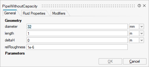

mo_diameter | diameter | inner diameter | Scalar | |
mo_length | length | pipe length | Scalar | |
mo_deltaH | deltaH | height difference | Scalar | |
mo_relRoughness | relRoughness | inner surface relative roughness | Scalar | |
mo_area | area | Scalar | ||
mo_fricConstant | fricConstant | Scalar |

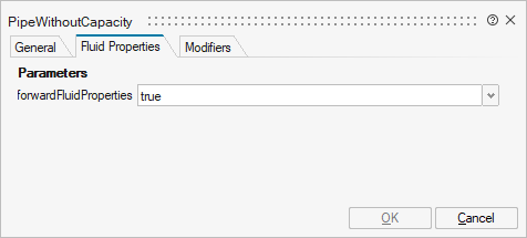

mo_forwardFluidProperties | forwardFluidProperties | Forward fluid properties between ports | Scalar | true |

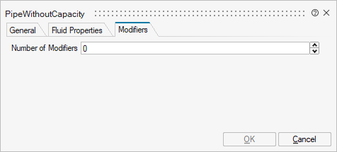

mo__modifiers/varname | Variable name | Cell of strings | 'volumeFlowA' | |
mo__modifiers/value | Value |
