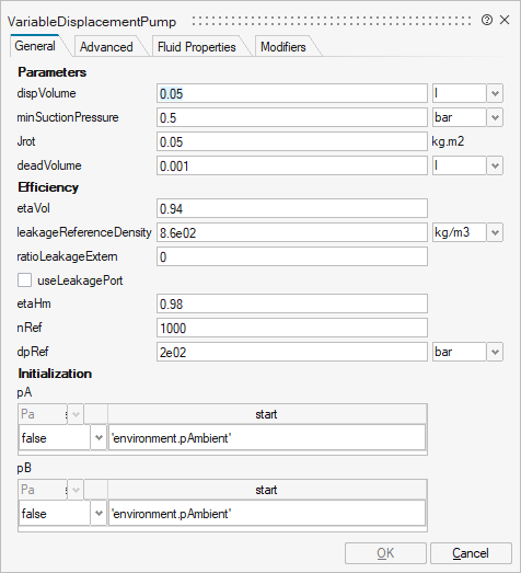

The losses are parameterised by providing volumetric and mechanical efficiencies Volumetric efficiency and Mechanical efficiency for a given operating point. The operating point is characterised by a reference pressure difference Reference pressure difference and a corresponding shaft speed Reference speed. Based on the entered values, the parameters of a laminar throttle (volumetric losses) and a linear damper (representing the mechanical losses) are determined automatically. Unlike the efficiencies, the parameters of these two elements typically do not vary significantly with the operating conditions.
The parameter Ratio external Leakage / total Leakage allows to split the leakage between internal and external leakage. A gear pump e. g. typically has no external leakage, Ratio external Leakage / total Leakage has to be set to 0. In contrast, a piston pump has a significant external leakage (0.5 < Ratio external Leakage / total Leakage <= 1).

mo_dispVolume | dispVolume | Displacement volume | Scalar | |

mo_etaVol | etaVol | Volumetric efficiency @ nRef, dpRef | Scalar | |
mo_leakageReferenceDensity | leakageReferenceDensity | Reference density for volumetric efficiency | Scalar | |
mo_ratioLeakageExtern | ratioLeakageExtern | Ratio external Leakage / total Leakage | Scalar | |
mo_useLeakagePort | useLeakagePort | Enable leakage port, otherwise implicitly connected with tank | Number | 0 |
mo_etaHm | etaHm | Mechanical efficiency @ nRef, dpRef | Scalar | |
mo_nRef | nRef | Reference speed (1/min) | Scalar | |
mo_dpRef | dpRef | Reference pressure difference | Scalar | |

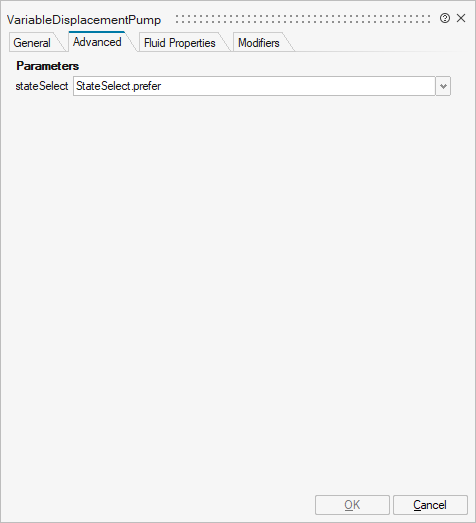

mo_stateSelect | stateSelect | Priority to use phi and w as states | Structure | |
mo_stateSelect/choice1 | StateSelect.never | Number | 0 | |
mo_stateSelect/choice2 | StateSelect.avoid | Number | 0 | |
mo_stateSelect/choice3 | StateSelect.default | Number | 0 | |
mo_stateSelect/choice4 | StateSelect.prefer | Number | 0 | |
mo_stateSelect/choice5 | StateSelect.always | Number | 0 |

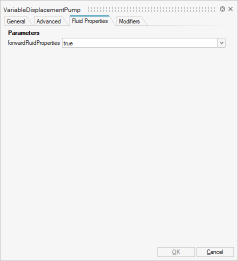

mo_forwardFluidProperties | forwardFluidProperties | Forward fluid properties between ports | Scalar | true |

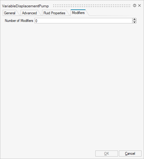

mo__modifiers/varname | Variable name | Cell of strings | 'volumeFlowA' | |
mo__modifiers/value | Value |
