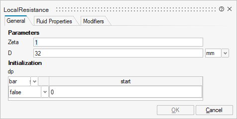

mo_Zeta | Zeta | Pressure loss coefficient | Scalar | |
mo_D | D | Diameter | Scalar | |
mo_InputMax | InputMax | Scalar | ||
mo_dp | dp | dp | Structure | |
mo_dp/fixed | fixed | Cell of scalars | true | |
mo_dp/start | start | Cell of scalars |

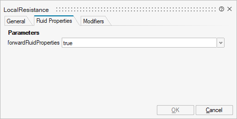

mo_forwardFluidProperties | forwardFluidProperties | Forward fluid properties between ports | Scalar | true |
