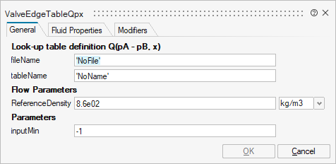

mo_fileName | fileName | File where look-up table is stored | String | |
mo_tableName | tableName | Table name on file | String | |
mo_ReferenceDensity | ReferenceDensity | Reference density | Scalar | |
mo_inputMin | inputMin | Minimum value of the input for look-up table | Scalar |

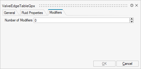

mo__modifiers/varname | Variable name | Cell of strings | 'dp' | |
mo__modifiers/value | Value |
