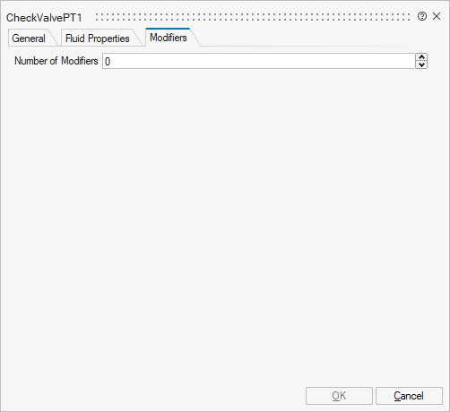

mo_resistorType | resistorType | Type of the resistor | Structure | |
mo_resistorType/choice1 | HydraulicsByFluidon.Types.TResistorTypes.Orifice | Number | 0 | |
mo_resistorType/choice2 | HydraulicsByFluidon.Types.TResistorTypes.Throttle | Number | 0 | |

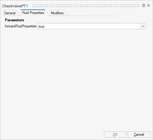

mo_forwardFluidProperties | forwardFluidProperties | Forward fluid properties between ports | Scalar | true |
mo__modifiers/varname | Variable name | Cell of strings | 'volumeFlowA' | |
mo__modifiers/value | Value |
