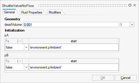

The component ShuttleValveNoFlow is the model of a changeover valve that has no flow through the valve, but only transmits the pressure. It connects port C (the middle port) with the port that has the highest pressure.
A typical application of this valve is in a load sensing system to determine the highest load pressure.
If you need a shuttle valve that also has a flow characteristic, you can use the component ShuttleValve.
mo_deadVolume | deadVolume | Dead volume at ports | Scalar | |
mo_pA/start | start | Cell of scalars | ||
mo_pB | pB | pB | Structure | |
mo_pB/fixed | fixed | Cell of scalars | true | |
mo_pB/start | start | Cell of scalars |
mo_forwardFluidProperties | forwardFluidProperties | Forward fluid properties between ports | Scalar | true |
mo__modifiers/value | Value |
fluidPortA | implicit | Hydraulic port A | input | 1 |
fluidPortB | implicit | Hydraulic port B | input | 2 |
fluidPortC | implicit | Hydraulic port C | input | 3 |
