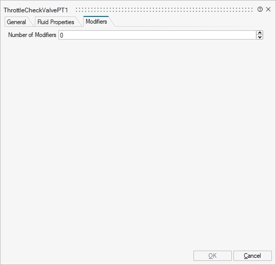

mo__modifiers/varname | Variable name | Cell of strings | 'volumeFlowA' | |
mo__modifiers/value | Value |
