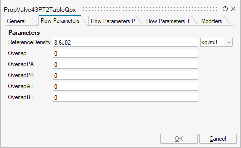

The valve stroke can be shifted by Relative overlap general. In accordance with common valve parameters a negative overlap will open the valve edge. Relative overlap general is applied to all valve edges simultaneously. If at least one of the edge-specific values, e. g. Relative overlap PA or -AT is set to a value different from 0, then the Relative overlap general is ignored and the individual overlaps are used.

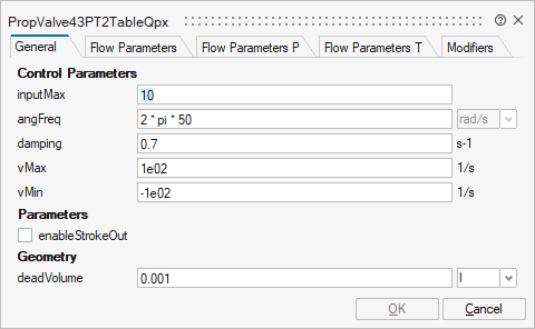

mo_inputMax | inputMax | Input value for 100 % open | Scalar | |
mo_angFreq | angFreq | Angular frequency | Scalar | |
mo_damping | damping | Damping | Scalar | |
mo_vMax | vMax | max. Velocity | Scalar | |
mo_vMin | vMin | min. Velocity | Scalar | |
mo_enableStrokeOut | enableStrokeOut | Enable Stroke Output | Number | 0 |
mo_inputMaxPartial | inputMaxPartial | Scalar | ||
mo_forwardFluidPropertiesBT | forwardFluidPropertiesBT | Scalar | true | |
mo_deadVolume | deadVolume | Dead volume at ports | Scalar | |

mo_ReferenceDensity | ReferenceDensity | Reference density | Scalar | |
mo_Overlap | Overlap | Valve edge general relative overlap | Scalar | |
mo_OverlapPA | OverlapPA | Valve edge PA relative overlap | Scalar | |
mo_OverlapPB | OverlapPB | Valve edge PB relative overlap | Scalar | |
mo_OverlapAT | OverlapAT | Valve edge AT relative overlap | Scalar | |
mo_OverlapBT | OverlapBT | Valve edge BT relative overlap | Scalar |

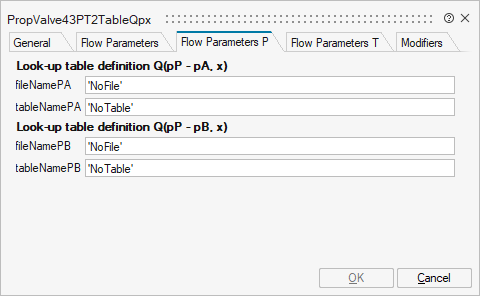

mo_fileNamePA | fileNamePA | File where look-up table is stored | String | |
mo_tableNamePA | tableNamePA | Table name on file | String | |
mo_fileNamePB | fileNamePB | File where look-up table is stored | String | |
mo_tableNamePB | tableNamePB | Table name on file | String |

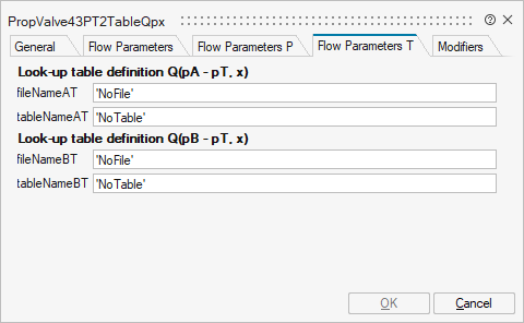

mo_fileNameAT | fileNameAT | File where look-up table is stored | String | |
mo_tableNameAT | tableNameAT | Table name on file | String | |
mo_fileNameBT | fileNameBT | File where look-up table is stored | String | |
mo_tableNameBT | tableNameBT | Table name on file | String |

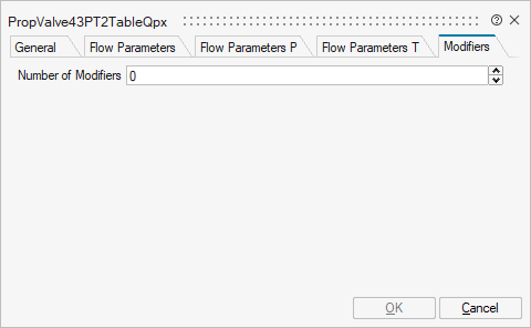

mo__modifiers/varname | Variable name | Cell of strings | 'volumeFlowP' | |
mo__modifiers/value | Value |
