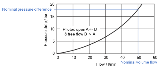

The flow characteristic of fully opened valve is given by parameters Nominal volume flow and Nominal pressure difference.

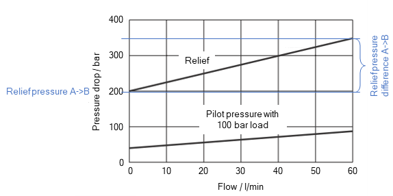

Relief and pilot performance diagram gives the parameters Relief pressure A->B and Relief pressure difference A->B.
Pilot ratio is one the main characteristics of a counter balance valve and is given in the data sheet.
Opening pressure difference B->A is a characteristics parameter of the check valve for reverse flow. It can be determined also from free flow diagram. In the presented diagram the opening pressure difference is very small. Typically, values are around 1 bar.

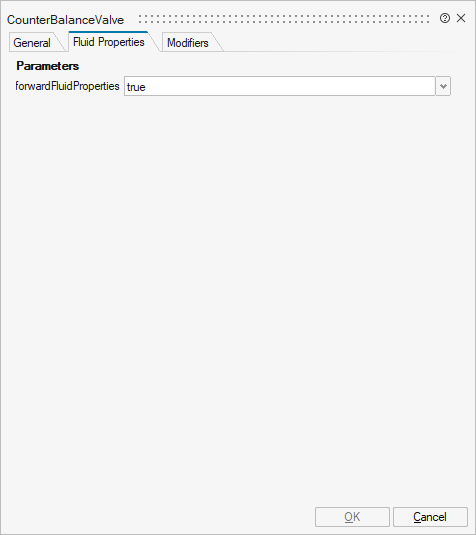

mo_forwardFluidProperties | forwardFluidProperties | Forward fluid properties between ports | Scalar | true |
