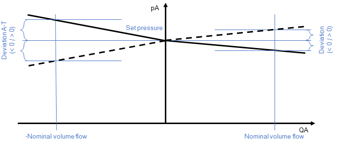

If supply pressure pA is less than Set pressure (relative value) the valve acts like an orifice with the characteristics Nominal volume flow and Nominal pressure difference.
For all pressures deviating from Set pressure (relative value) the valve opens and the flow increases linearly following the slope given by parameters Nominal volume flow and Pressure drop. For flow P->A the outlet pressure deviates by Deviation P-A @ Nominal volume flow and by Deviation P-A @ -Nominal volume flow for flow A->T.

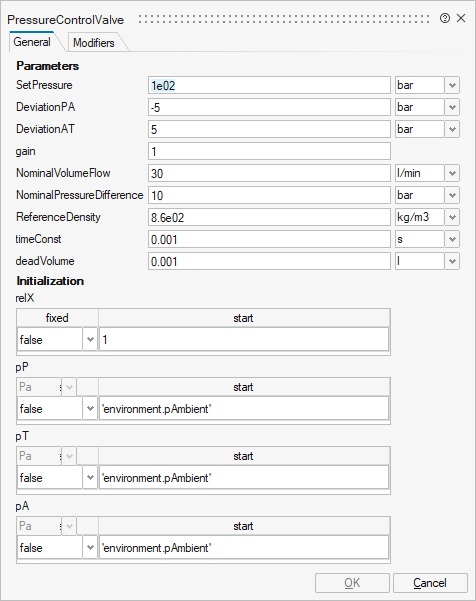

mo_SetPressure | SetPressure | Set pressure (relative value) | Scalar | |
mo_DeviationPA | DeviationPA | Deviation P-A | Scalar | |
mo_DeviationAT | DeviationAT | Deviation A-T | Scalar | |
mo_gain | gain | Controller gain | Scalar | |
mo_NominalVolumeFlow | NominalVolumeFlow | Nominal volume flow | Scalar | |
mo_NominalPressureDifference | NominalPressureDifference | Nominal pressure difference | Scalar | |
mo_ReferenceDensity | ReferenceDensity | Reference density for volume flow and pressure difference | Scalar | |
mo_timeConst | timeConst | Response time of valve spool | Scalar | |
mo_deadVolume | deadVolume | Dead volume at ports | Scalar | |
mo_SetPressureAbs | SetPressureAbs | Scalar | ||
mo_relX | relX | relX | Structure | |
mo_relX/fixed | fixed | Cell of scalars | true | |
mo_relX/start | start | Cell of scalars | ||
mo_pP | pP | pP | Structure | |
mo_pP/fixed | fixed | Cell of scalars | true | |
mo_pP/start | start | Cell of scalars | ||
mo_pT | pT | pT | Structure | |
mo_pT/fixed | fixed | Cell of scalars | true | |
mo_pT/start | start | Cell of scalars | ||
mo_pA/start | start | Cell of scalars |

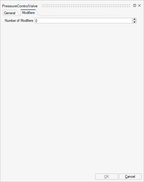

mo__modifiers/varname | Variable name | Cell of strings | 'volumeFlowP' | |
mo__modifiers/value | Value |
