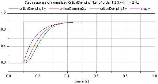

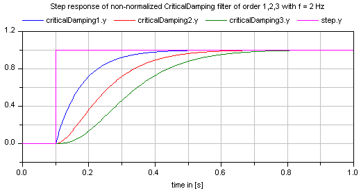

If parameter normalized = true (default), the filteris normalized such that the amplitude of the filter transfer functionat the cut-off frequency f is 1/sqrt(2) (= 3 dB). Otherwise, the filteris not normalized, i.e., it is unmodified. A normalized filter is usuallymuch better for applications, since filters of different orders are"comparable", whereas non-normalized filters usually require to adapt thecut-off frequency, when the order of the filter is changed.Figures of the filter step responses are shown below.Note, in versions before version 3.0 of the Modelica Standard library,the CriticalDamping filter was provided only in non-normalized form.

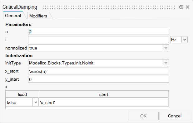

mo_n | n | Order of filter | Scalar | |
mo_f | f | Cut-off frequency | Scalar | |
mo_normalized | normalized | = true, if amplitude at f_cut is 3 dB, otherwise unmodified filter | Scalar | true |
mo_alpha | alpha | Frequency correction factor for normalized filter | Scalar | |
mo_w | w | Scalar | ||
mo_initType | initType | Type of initialization (1: no init, 2: steady state, 3: initial state, 4: initial output) | Structure | |
mo_initType/choice1 | Modelica.Blocks.Types.Init.NoInit | Number | 0 | |
mo_initType/choice2 | Modelica.Blocks.Types.Init.SteadyState | Number | 0 | |
mo_initType/choice3 | Modelica.Blocks.Types.Init.InitialState | Number | 0 | |
mo_initType/choice4 | Modelica.Blocks.Types.Init.InitialOutput | Number | 0 | |
mo_x_start | x_start | Initial or guess values of states | Vector | |
mo_y_start | y_start | Initial value of output (remaining states are in steady state) | Scalar | |
mo_x | x | x | Structure | |
mo_x/fixed | fixed | Cell of vectors | true | |
mo_x/start | start | Cell of vectors |

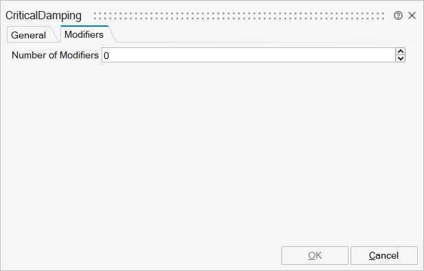

mo__modifiers/value | Value |
