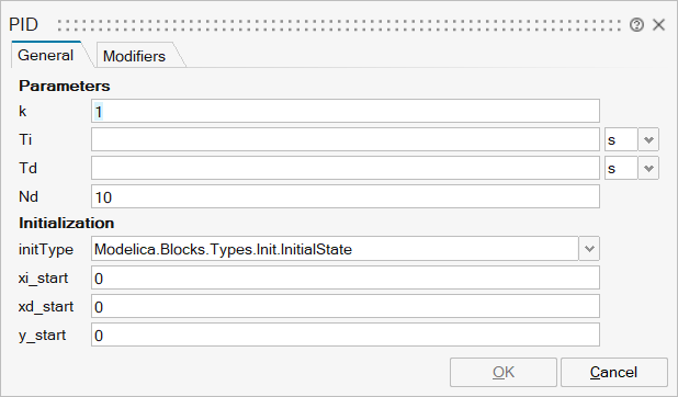

mo_k | k | Gain | Scalar | |
mo_Ti | Ti | Time Constant of Integrator | Scalar | |
mo_Td | Td | Time Constant of Derivative block | Scalar | |
mo_Nd | Nd | The higher Nd, the more ideal the derivative block | Scalar | |
mo_initType | initType | Type of initialization (1: no init, 2: steady state, 3: initial state, 4: initial output) | Structure | |
mo_initType/choice1 | Modelica.Blocks.Types.Init.NoInit | Number | 0 | |
mo_initType/choice2 | Modelica.Blocks.Types.Init.SteadyState | Number | 0 | |
mo_initType/choice3 | Modelica.Blocks.Types.Init.InitialState | Number | 0 | |
mo_initType/choice4 | Modelica.Blocks.Types.Init.InitialOutput | Number | 0 | |
mo_xi_start | xi_start | Initial or guess value for integrator output (= integrator state) | Scalar | |
mo_xd_start | xd_start | Initial or guess value for state of derivative block | Scalar | |
mo_y_start | y_start | Initial value of output | Scalar |
