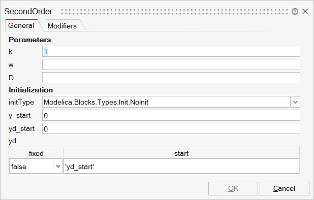

This blocks defines the transfer function between the input u andthe output y as second order system:
ky = --------------------------------- * u ( s / w )^2 + 2*D*( s / w ) + 1
If you would like to be able to change easily between differenttransfer functions (FirstOrder, SecondOrder, ... ) by changingparameters, use the general model class TransferFunctioninstead and model a second order SISO system with parameters
b = {k}, a = {1/w^2, 2*D/w, 1}.
Example: parameter: k = 0.3, w = 0.5, D = 0.4 results in: 0.3 y = ------------------- * u 4.0 s^2 + 1.6 s + 1
mo_k | k | Gain | Scalar | |
mo_w | w | Angular frequency | Scalar | |
mo_D | D | Damping | Scalar | |
mo_initType | initType | Type of initialization (1: no init, 2: steady state, 3/4: initial output) | Structure | |
mo_initType/choice1 | Modelica.Blocks.Types.Init.NoInit | Number | 0 | |
mo_initType/choice2 | Modelica.Blocks.Types.Init.SteadyState | Number | 0 | |
mo_initType/choice3 | Modelica.Blocks.Types.Init.InitialState | Number | 0 | |
mo_initType/choice4 | Modelica.Blocks.Types.Init.InitialOutput | Number | 0 | |
mo_y_start | y_start | Initial or guess value of output (= state) | Scalar | |
mo_yd_start | yd_start | Initial or guess value of derivative of output (= state) | Scalar | |
mo_yd | yd | yd | Structure | |
mo_yd/fixed | fixed | Cell of scalars | true | |
mo_yd/start | start | Cell of scalars |

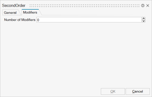

mo__modifiers/value | Value |
