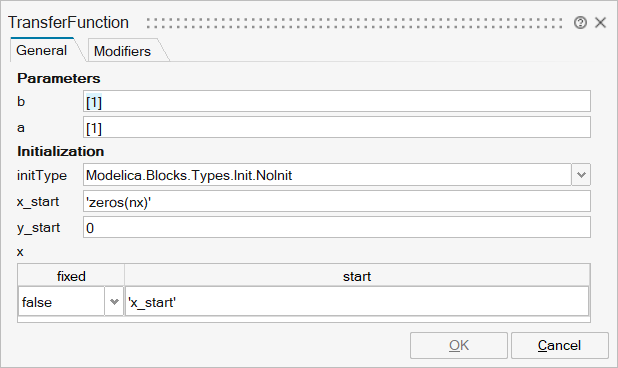

mo_b | b | Numerator coefficients of transfer function (e.g., 2*s+3 is specified as {2,3}) | Vector | |
mo_a | a | Denominator coefficients of transfer function (e.g., 5*s+6 is specified as {5,6}) | Vector | |
mo_na | na | Size of Denominator of transfer function. | Scalar | |
mo_nb | nb | Size of Numerator of transfer function. | Scalar | |
mo_nx | nx | Scalar | ||
mo_bb | bb | Vector | ||
mo_d | d | Scalar | ||
mo_a_end | a_end | Scalar | ||
mo_initType | initType | Type of initialization (1: no init, 2: steady state, 3: initial state, 4: initial output) | Structure | |
mo_initType/choice1 | Modelica.Blocks.Types.Init.NoInit | Number | 0 | |
mo_initType/choice2 | Modelica.Blocks.Types.Init.SteadyState | Number | 0 | |
mo_initType/choice3 | Modelica.Blocks.Types.Init.InitialState | Number | 0 | |
mo_initType/choice4 | Modelica.Blocks.Types.Init.InitialOutput | Number | 0 | |
mo_x_start | x_start | Initial or guess values of states | Vector | |
mo_y_start | y_start | Initial value of output (derivatives of y are zero up to nx-1-th derivative) | Scalar | |
mo_x | x | x | Structure | |
mo_x/fixed | fixed | Cell of vectors | true | |
mo_x/start | start | Cell of vectors |

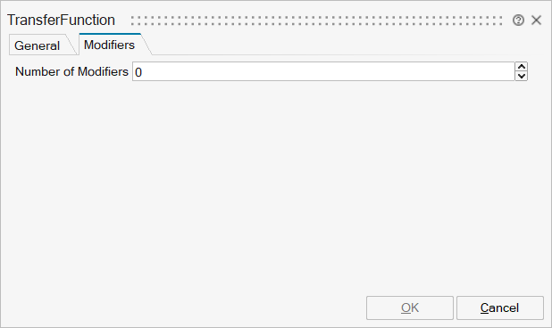

mo__modifiers/varname | Variable name | Cell of strings | 'x_scaled' | |
mo__modifiers/value | Value |
