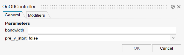

OnOffController
On-off controller
Modelica/Blocks/Logical
The block OnOffController sets the output signal y to true whenthe input signal u falls below the reference signal minus half ofthe bandwidth and sets the output signal y to false when the inputsignal u exceeds the reference signal plus half of the bandwidth.
mo_bandwidth | bandwidth | Bandwidth around reference signal | Scalar | |
mo_pre_y_start | pre_y_start | Value of pre(y) at initial time | Scalar | true |
mo__modifiers/value | Value |
