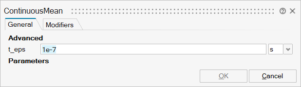

The parameter t_eps is used to guard against division by zero (the mean value computationstarts at <simulation start time> + t_eps and before that time instant y = u).
See also the Mean block for a sampled implementation.
This block is demonstrated in the examplesUniformNoiseProperties andNormalNoiseProperties.

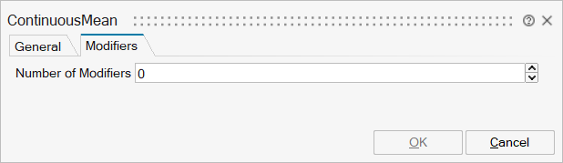

mo_t_eps | t_eps | Mean value calculation starts at startTime + t_eps | Scalar | |
mo_t_0 | t_0 | Start time | Scalar |
mo__modifiers/varname | Variable name | Cell of strings | 'mu' | |
mo__modifiers/value | Value |
