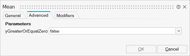

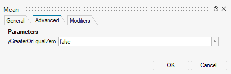

If parameter yGreaterOrEqualZero in the Advanced tab is true (default = false),then the modeller provides the information that the mean of the input signal is guaranteedto be ≥ 0 for the exact solution. However, due to inaccuracies in the numerical integration scheme,the output might be slightly negative. If this parameter is set to true, then the output isexplicitly set to 0.0, if the mean value results in a negative value.

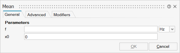

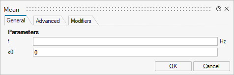

mo_f | f | Base frequency | Scalar | |
mo_x0 | x0 | Start value of integrator state | Scalar | |

mo_yGreaterOrEqualZero | yGreaterOrEqualZero | = true, if output y is guaranteed to be >= 0 for the exact solution | Scalar | true |

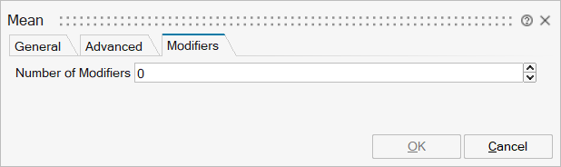

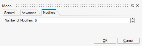

mo__modifiers/varname | Variable name | Cell of strings | 'x' | |
mo__modifiers/value | Value |
