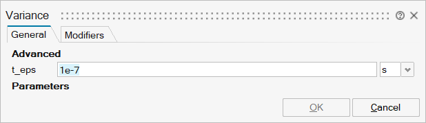

The parameter t_eps is used to guard against division by zero (the variance computationstarts at <simulation start time> + t_eps and before that time instant y = 0).
The variance of a signal is also equal to its mean power.
This block is demonstrated in the examplesUniformNoiseProperties andNormalNoiseProperties.
mo_t_eps | t_eps | Variance calculation starts at startTime + t_eps | Scalar | |

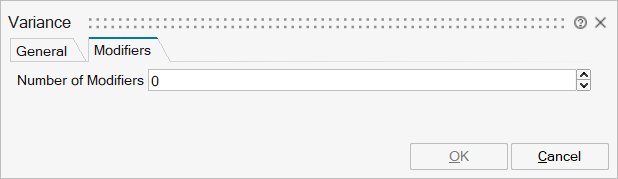

mo__modifiers/varname | Variable name | Cell of strings | 'mu' | |
mo__modifiers/value | Value |
