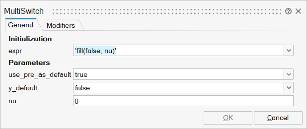

mo_expr | expr | Sets y = if u[i] then expr[i] else y_default (time varying) | Vector | true |
mo_use_pre_as_default | use_pre_as_default | Set true to hold last value as default (y_default = pre(y)) | Scalar | true |
mo_y_default | y_default | Default value of output y if all u[i] = false | Scalar | true |
mo_nu | nu | Number of input connections | Scalar |

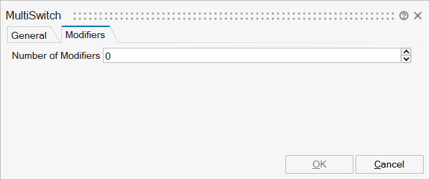

mo__modifiers/varname | Variable name | Cell of strings | 'firstActiveIndex' | |
mo__modifiers/value | Value |
